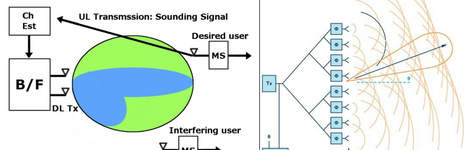

Beamforming
Beamforming, also known as spatial filtering, is a signal processing technique for directional transmission and reception of signals. As stated in marketing materials, the router no longer lights up in all directions, but follows the user with a beam.
From a technical perspective, a directed beam is created by combining elements in an antenna array such that signals at certain angles experience constructive interference while others experience destructive interference. As a result, a beam pattern arises, which provides a qualitative signal improvement compared to omnidirectional reception/transmission. Beamforming is used for spatial selectivity at both the transmitter and the receiver. The technique has found numerous applications in radar, sonar, seismology, wireless communications, radio astronomy, acoustics and biomedicine.

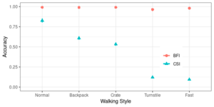

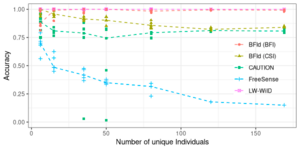

In a study with 197 participants the researchers were able to identify people with almost 100% accuracy, independent of angle or gait. However, this required rather long ML model training, including 20 preliminary passes of each person in the training sample. And tests were not conducted with two subjects simultaneously, only one at a time. So overall the experiment can be considered fairly synthetic, although the recognition accuracy is indeed impressive.
*recognition accuracy depending on gait (normal, with a backpack, carrying a box, fast).

*recognition accuracy depending on the number of subjects in the sample.
